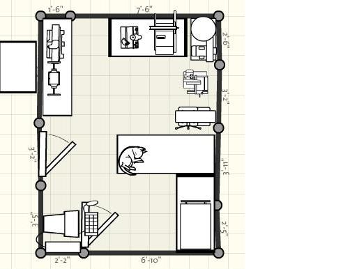

Mine is still under construction but here is the layout.
I laid out the design using the shop design application at GrizzlyDon A38597.7307638889

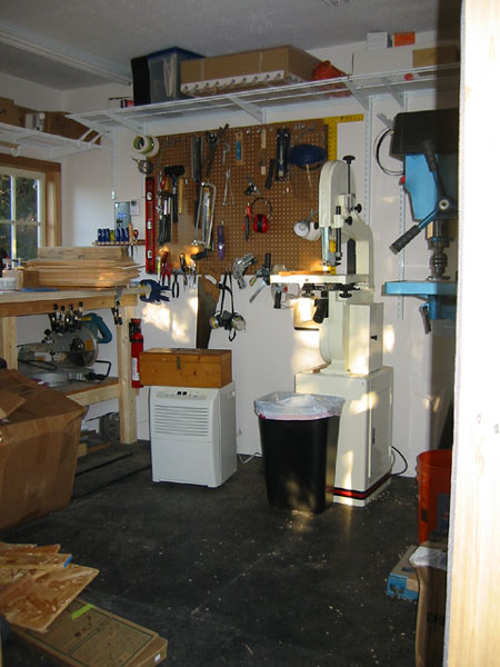

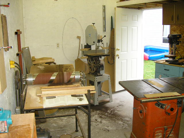

I manage to get by with a tiny shop and a covered patio.   My shop is 9ft x 14ft. Here's an image of my shop:
I have all my dust making stuff out on the covered patio -- my bandsaw, drill press, table saw, chop saw and drum sander. I also do all my sanding with my random orbital sander out there too.

How were you able to copy that file to post it? I can't seem to find any other option other than to save it to the grizzly website.
PostPosted: Fri Sep 02, 2005 12:49 pm
John, I captured it to the clipboard using Shift Print Sceen. I then started Paint and pasted it into a new image with Ctrl-V. I then highlighted the part I wanted and copied and pasted it into another new file.

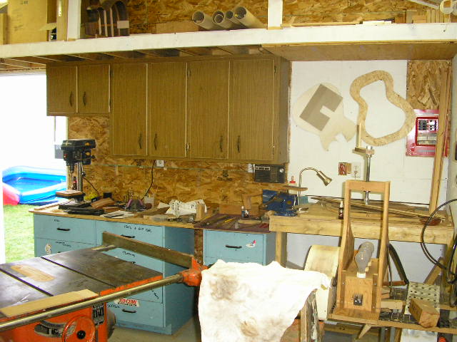

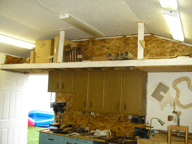

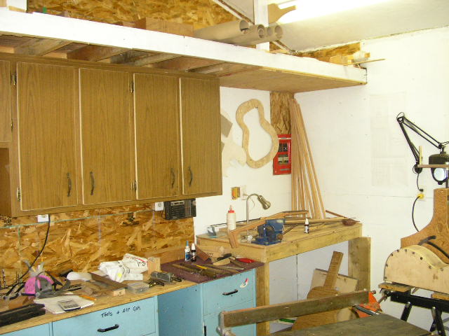

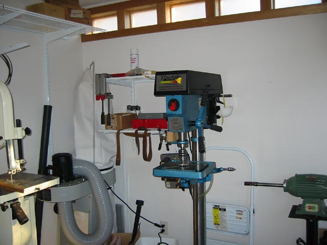

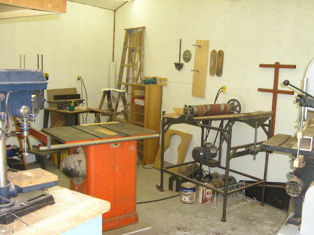

Wow Jimson, that is a small space. I thought mine was a small space at 185 sft. Here are some pics of my shop. I have a full size cabinet saw, 24" homemade drum sander, 14" delta bandsaw, 4" jointer and a 20" x 80" bench with upper cabinets above it plus a 28" x 50" builtin gobar deck. The best thing about my shop is the loft I built in. The loft stores all my materials, jigs and fixtures.
PostPosted: Sat Sep 03, 2005 7:14 am
rod, your unisaw looks to about the same vintage as mine, though i haven't resprayed it a lairy red.
you've certainly made very efficient use of your space.
PostPosted: Sat Sep 03, 2005 9:21 am
Michael, I still have a couple of thing to go into the shop. I am making a cyclone similar to the one mentioned in the cyclone post and it is going to go in the corner bewteen the sander and the bandsaw. Than I want to make a knock down spray booth in the corner where the ladders are.

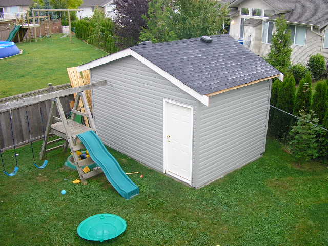

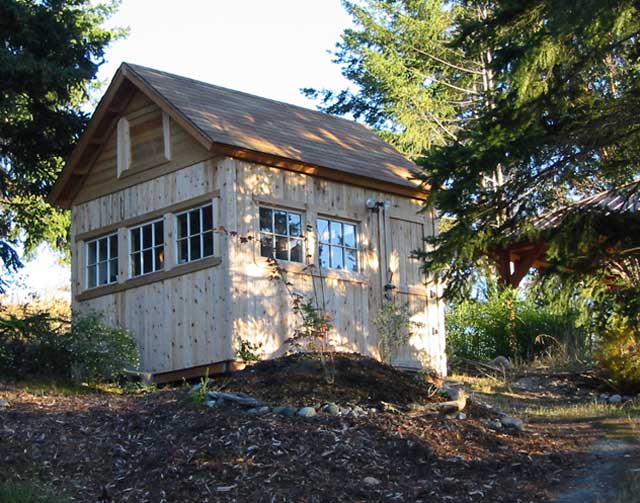

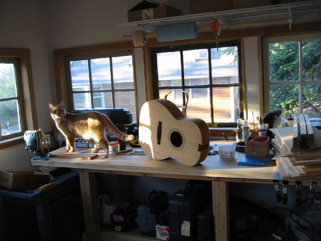

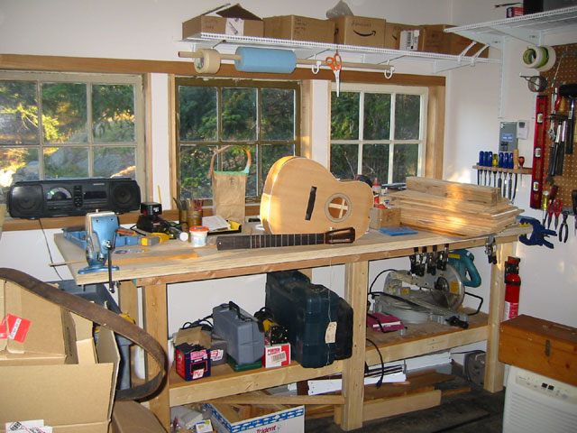

I just finished my small shop. I kept it to 120 square feet so I wouldn't have to get a permit and by the time I finished, the codes had bumped the minimum size up to 200, so I might add a shed roof addition in a few years. I have a band saw and drill press as my big items. My table saw is in the garage and never would have made it up the hill anyway.
The copper roofed structure to the right is my neighbor's new timber framed hot tub gazebo made with purpleheart timbers. I’m wondering how much I can shave off for bindings before it becomes noticeable.
I thickness with a safety planer before taking down the road to a buddies thickness sander.
Organization is the key to working in a small area, which I'm still working on.
Requisite cat.
